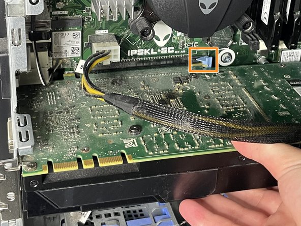

    • Unlock the blue latch and pull to remove the graphics card.

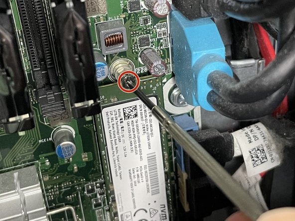

    • Use the Phillips #1 screwdriver to remove the 3.7 mm screw and remove the old M2 SSD.
Conclusione
Ensure that you tightly screwed on the M2 SSD and that you inserted the graphics card back to its position so that the PC runs smoothly with no problems. Once you have completed all the steps and reconnected the cables you have successfully replaced the NVMe M2 SSD and your PC is ready to be turned on!
