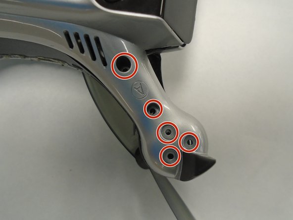

    • Flip the AEE Mach 1 upside down.
    • Remove the screws on the drone's arms using a Torx T5 screwdriver.

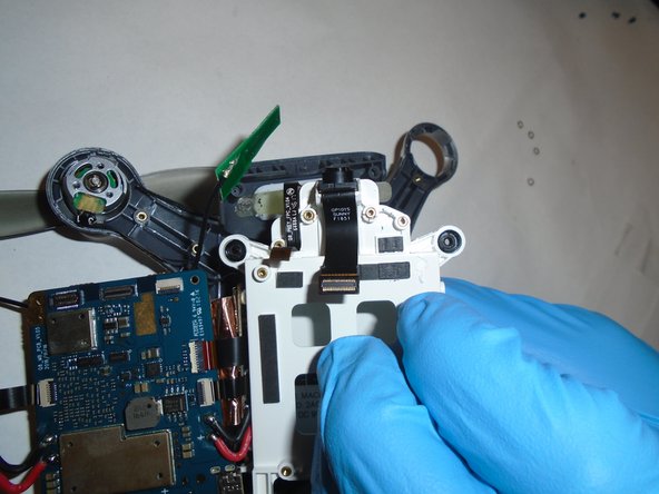

  5. AEE Mach 1 Camera Replacement: passo 5, immagine 1 di 1
    • Using a Phillips #00 screwdriver, remove the screws from the four corners of the inner white chassis.

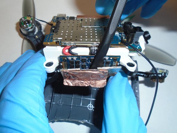

  6. AEE Mach 1 Camera Replacement: passo 6, immagine 1 di 2 AEE Mach 1 Camera Replacement: passo 6, immagine 2 di 2
    • Using a Spudger (or similar tool to scrap/pry with), remove the copper foil used as tape from the sides of the chassis.
    • Remove the small metal covering from the side boards.
    • This can be done by hand or with the assistance of a prying tool.

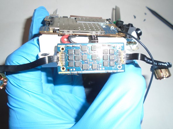

  7. AEE Mach 1 Camera Replacement: passo 7, immagine 1 di 2 AEE Mach 1 Camera Replacement: passo 7, immagine 2 di 2
    • Using a Phillips #00 screwdriver, remove the four screws separating the side board from the white chassis.

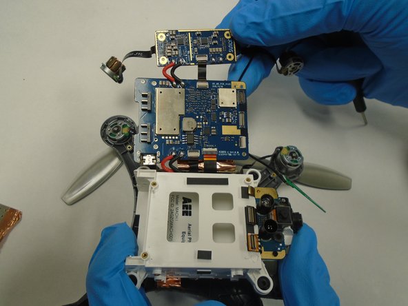

  8. AEE Mach 1 Camera Replacement: passo 8, immagine 1 di 2 AEE Mach 1 Camera Replacement: passo 8, immagine 2 di 2

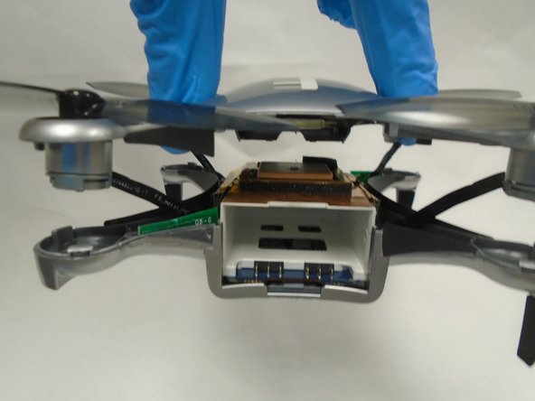

    • Using a Phillips #00 screwdriver, remove the four screws from the large motherboard on the white chassis.
    • Lift the motherboard out of the case, revealing the camera cable.

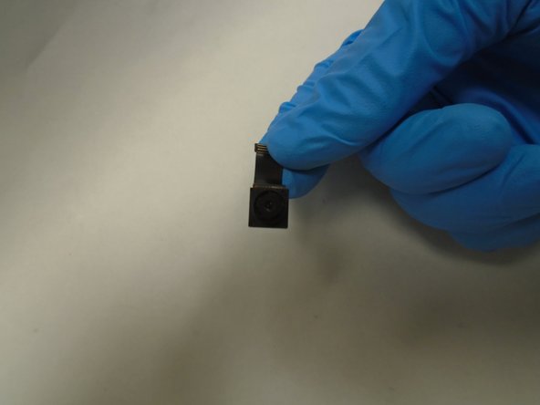

  9. AEE Mach 1 Camera Replacement: passo 9, immagine 1 di 3 AEE Mach 1 Camera Replacement: passo 9, immagine 2 di 3 AEE Mach 1 Camera Replacement: passo 9, immagine 3 di 3
    • Using the Phillips #00 screwdriver, remove the four screws holding the camera mechanism in place.
    • Lift the camera assembly out of the case.
