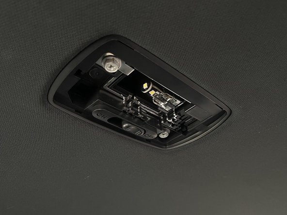

    1. 2020 Honda Civic Cabin Lights Replacement, Cabin Lights: passo 1, immagine 1 di 3 2020 Honda Civic Cabin Lights Replacement, Cabin Lights: passo 1, immagine 2 di 3 2020 Honda Civic Cabin Lights Replacement, Cabin Lights: passo 1, immagine 3 di 3
      • Open the trunk.
      • The cabin light for the trunk will be located on the roof of the trunk.

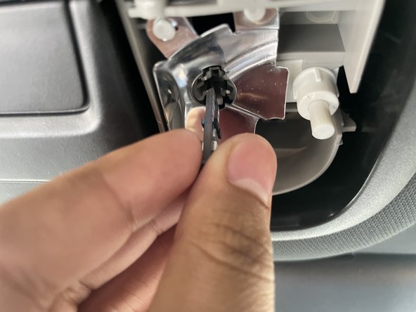

    6. 2020 Honda Civic Cabin Lights Replacement: passo 6, immagine 1 di 3 2020 Honda Civic Cabin Lights Replacement: passo 6, immagine 2 di 3 2020 Honda Civic Cabin Lights Replacement: passo 6, immagine 3 di 3
      • Wedge a prying tool into the corner of the frame.
      • Once the cover pops out, use the end of another prying tool to fully remove it.
      Chiedi a FixBot
      Aggiungi Commento
    7. 2020 Honda Civic Cabin Lights Replacement: passo 7, immagine 1 di 3 2020 Honda Civic Cabin Lights Replacement: passo 7, immagine 2 di 3 2020 Honda Civic Cabin Lights Replacement: passo 7, immagine 3 di 3
      • With the cover completely removed, begin removing the light bulb.
      • If the light bulb is difficult to remove, use your prying tool to assist in removing the light bulb.

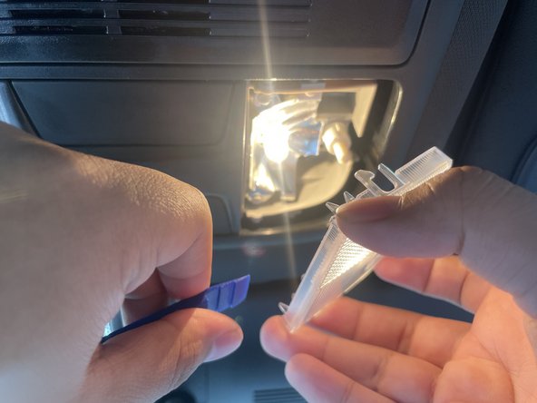

    10. 2020 Honda Civic Cabin Lights Replacement: passo 10, immagine 1 di 3 2020 Honda Civic Cabin Lights Replacement: passo 10, immagine 2 di 3 2020 Honda Civic Cabin Lights Replacement: passo 10, immagine 3 di 3
      • Move to the to cabin lights in the front of the driver and passenger seat.
      • Each front cabin light has its own switch. We will start with the driver's side light.
      • Wedge the prying tool into the crevice on the inside of the cover.
      • Push carefully to release and remove the cover.
