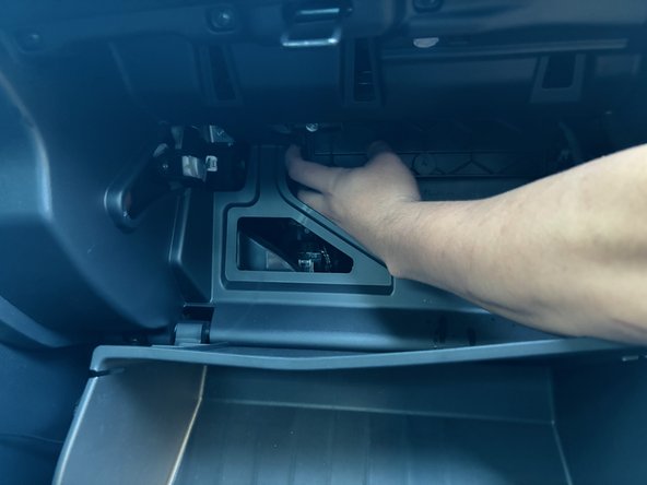

    • Locate the Cabin in the passenger side of the car.

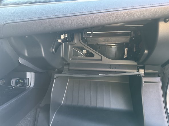

  2. 2020 Honda Civic Cabin Filter Replacement: passo 2, immagine 1 di 3 2020 Honda Civic Cabin Filter Replacement: passo 2, immagine 2 di 3 2020 Honda Civic Cabin Filter Replacement: passo 2, immagine 3 di 3
    • Locate the two pins holding the cabin in place.
    • Apply pressure on both sides and pull down.

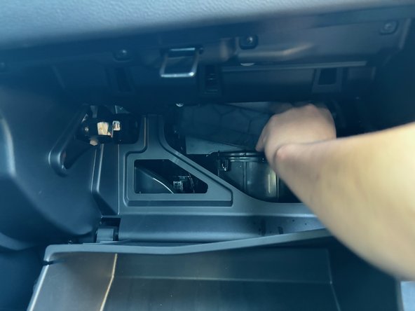

  3. 2020 Honda Civic Cabin Filter Replacement: passo 3, immagine 1 di 2 2020 Honda Civic Cabin Filter Replacement: passo 3, immagine 2 di 2
    • Locate two pins on both sides of air filter cabin.
    • Push inwards and pull to take out. (usually only one is enough to take the entire thing out)
  4. 2020 Honda Civic Cabin Filter Replacement: passo 4, immagine 1 di 1
    • Locate the air filter.
    • It should either be empty or have a used one inside.
  5. 2020 Honda Civic Cabin Filter Replacement: passo 5, immagine 1 di 2 2020 Honda Civic Cabin Filter Replacement: passo 5, immagine 2 di 2
    • Take out filter and replace with brand new one.
