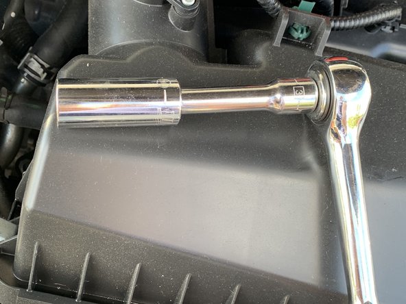

  4. 2019 Honda Civic Spark Plugs Replacement: passo 4, immagine 1 di 3 2019 Honda Civic Spark Plugs Replacement: passo 4, immagine 2 di 3 2019 Honda Civic Spark Plugs Replacement: passo 4, immagine 3 di 3
    • Make sure the spark plug area is dry before removing the spark plug.
    • Attach the socket to the socket wrench.
    • Put the socket inside the cylinder head and twist the socket wrench to remove the spark plug.
