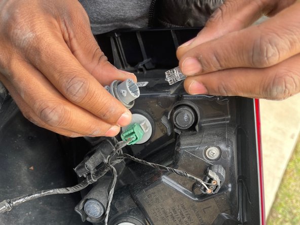

    4. 2017 Honda Civic Sport Brake Light Bulb Replacement: passo 4, immagine 1 di 2 2017 Honda Civic Sport Brake Light Bulb Replacement: passo 4, immagine 2 di 2
      • Grip light bulb and slide it directly out of its socket.

    5. 2017 Honda Civic Sport Brake Light Bulb Replacement: passo 5, immagine 1 di 3 2017 Honda Civic Sport Brake Light Bulb Replacement: passo 5, immagine 2 di 3 2017 Honda Civic Sport Brake Light Bulb Replacement: passo 5, immagine 3 di 3
      • Install a new bulb by pressing it into the socket.
      • You'll hear a "click" when it's properly inserted.
