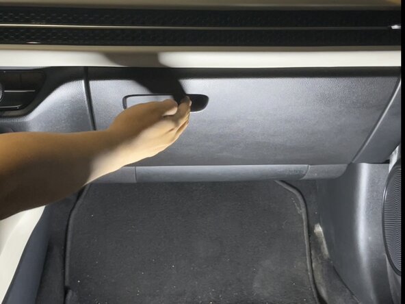

      • Pull the lever to open the glove box.
      • If the glove box is full, remove items for easier access to the cabin filter.

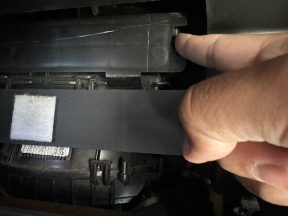

    3. 2017 Chevy Malibu Cabin Air Filter Replacement: passo 3, immagine 1 di 3 2017 Chevy Malibu Cabin Air Filter Replacement: passo 3, immagine 2 di 3 2017 Chevy Malibu Cabin Air Filter Replacement: passo 3, immagine 3 di 3
      • Push up on the damping latch and pull it out.

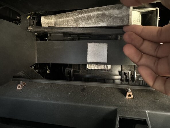

    4. 2017 Chevy Malibu Cabin Air Filter Replacement: passo 4, immagine 1 di 2 2017 Chevy Malibu Cabin Air Filter Replacement: passo 4, immagine 2 di 2
      • Unlatch both ends of the filter door and open it to reveal the old filter.
      • Pull out the old cabin filter and throw it away.
      • Insert the new filter.
      • Be sure to insert it so the airflow follows the correct direction, as indicated by the arrows on the filter.
