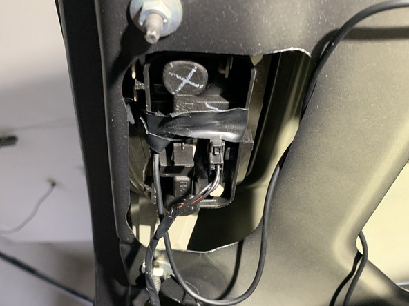

  4. 2008-2011 Saab 9-3 Reverse Light Replacement: passo 4, immagine 1 di 1
    • Gently pull down on the trunk lining to access the light socket.
    • You may need a second pair of hands to help hold down the lining unless all fasteners are removed. If not, the lining will naturally return to its original position.

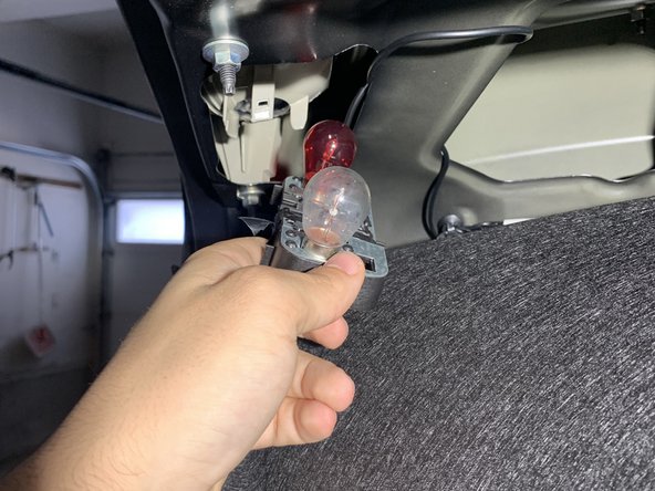

  5. 2008-2011 Saab 9-3 Reverse Light Replacement: passo 5, immagine 1 di 2 2008-2011 Saab 9-3 Reverse Light Replacement: passo 5, immagine 2 di 2
    • Use light pressure to pull the tab on the light socket towards you.
    • Gently pull down on the light socket to remove.

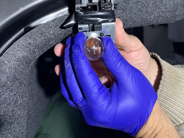

  6. 2008-2011 Saab 9-3 Reverse Light Replacement: passo 6, immagine 1 di 2 2008-2011 Saab 9-3 Reverse Light Replacement: passo 6, immagine 2 di 2
    • Push down and twist the lightbulb counterclockwise to remove it.
    • Wear gloves when doing this to prevent getting oil from your fingers on the bulb.

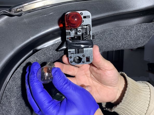

  7. 2008-2011 Saab 9-3 Reverse Light Replacement: passo 7, immagine 1 di 1
    • Insert the replacement lightbulb by pushing down and twisting clockwise.
