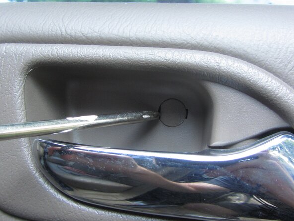

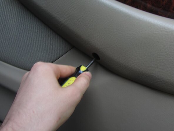

    • Use a Phillips #00 screwdriver to remove the screw covers and screws behind the door handle and on the center doorframe.
    • Set them aside for reassembly.
    • If you're working on reassembling specifically the front driver's side door, you may have to remove the handle by shifting it right, then detaching it by unplugging the memory board located on the back. Other passenger doors won't have this additional step.

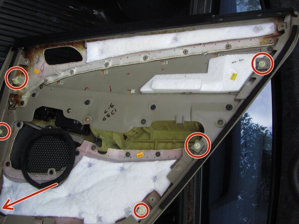

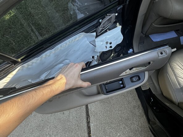

  2. 2003 Acura TL Window Regulator Replacement: passo 2, immagine 1 di 3 2003 Acura TL Window Regulator Replacement: passo 2, immagine 2 di 3 2003 Acura TL Window Regulator Replacement: passo 2, immagine 3 di 3

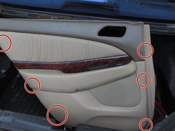

    • Using a trim removal tool, begin separating the door cover from the door. While separating, carefully undo the clips attaching the door to its frame.
    • The clips are very fragile. Ensure the clips don't get damaged during separation.

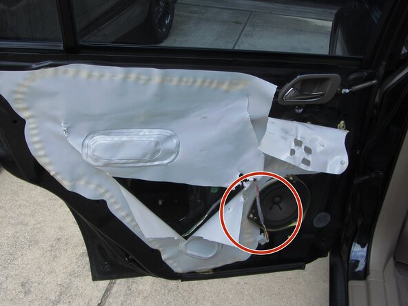

  3. 2003 Acura TL Window Regulator Replacement: passo 3, immagine 1 di 1
    • Carefully unplug the speaker and window control cable connectors from the door. Press down on each connector to release it from its socket.
    • The driver's side door, which has a memory board, may have additional wires to disconnect.

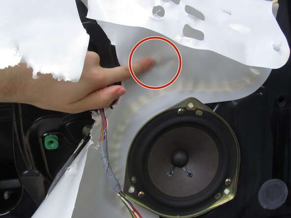

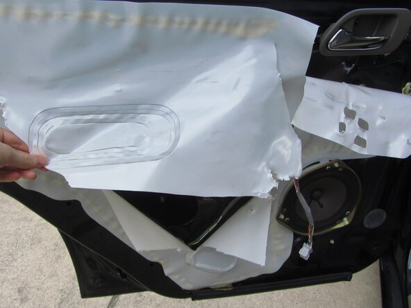

  4. 2003 Acura TL Window Regulator Replacement: passo 4, immagine 1 di 2 2003 Acura TL Window Regulator Replacement: passo 4, immagine 2 di 2
    • Carefully pull off the weather seal so you have access to the internal part of the door.
    • Try to avoid tearing it as you will need to use it once you are done with the repair.

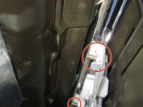

  6. 2003 Acura TL Window Regulator Replacement: passo 6, immagine 1 di 3 2003 Acura TL Window Regulator Replacement: passo 6, immagine 2 di 3 2003 Acura TL Window Regulator Replacement: passo 6, immagine 3 di 3
    • Use a socket wrench to unscrew the bolts attaching the window regulator to the doorframe.
    • You may need to tear the weather seal back more to have better access to the bolts.
  7. 2003 Acura TL Window Regulator Replacement: passo 7, immagine 1 di 3 2003 Acura TL Window Regulator Replacement: passo 7, immagine 2 di 3 2003 Acura TL Window Regulator Replacement: passo 7, immagine 3 di 3
    • Push the bolts out from inside the doorframe.
    • Remove the window regulator.
    • Replace the old window regulator with the new one, rescrewing bolts and reassembling the doorframe.
