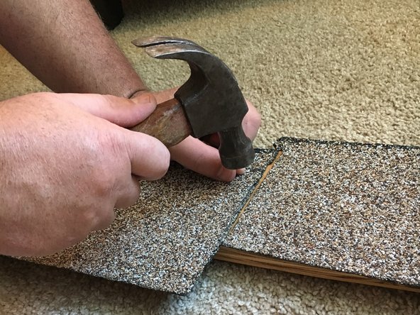

  1. Roof Shingle Replacement, Roof shingle: passo 1, immagine 1 di 1
    • Remove the broken shingle by lifting the nails with the claw side of a hammer.
    • Use caution when handling a hammer and nails.
  2. Roof Shingle Replacement: passo 2, immagine 1 di 1
    • Remove the single broken shingle, carefully, without ripping out the shingles above.
  3. Roof Shingle Replacement: passo 3, immagine 1 di 1
    • Remove the adhesion strip off of the new shingle.
  4. Roof Shingle Replacement: passo 4, immagine 1 di 1
    • Slip the new shingle in place, and line it up where the old shingle previously was.
  5. Roof Shingle Replacement: passo 5, immagine 1 di 2 Roof Shingle Replacement: passo 5, immagine 2 di 2
    • Secure the shingle with three 7/8" roofing nails.
    • Be careful when hammering in the nails.
  6. Roof Shingle Replacement: passo 6, immagine 1 di 1
    • Slightly lift the edges of the shingle and apply a thin layer of cement along it.
  7. Roof Shingle Replacement: passo 7, immagine 1 di 1
    • Press down the edges to lock the shingle in place.
