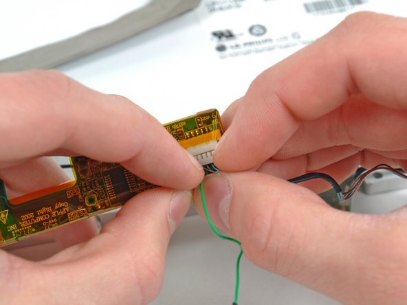

  31. PowerBook G4 Aluminum 17" 1-1.67 GHz Inverter and Antenna Cables Replacement, Inverter and Antenna Cables: passo 34, immagine 1 di 2 PowerBook G4 Aluminum 17" 1-1.67 GHz Inverter and Antenna Cables Replacement, Inverter and Antenna Cables: passo 34, immagine 2 di 2
    • Carefully grasp the inverter connector with the ends of your fingertips and pull it straight down.

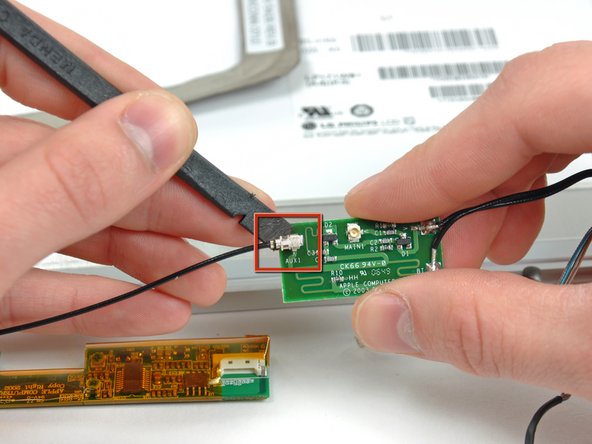

  32. PowerBook G4 Aluminum 17" 1-1.67 GHz Inverter and Antenna Cables Replacement: passo 35, immagine 1 di 2 PowerBook G4 Aluminum 17" 1-1.67 GHz Inverter and Antenna Cables Replacement: passo 35, immagine 2 di 2
    • Peel the protective translucent shield off the antenna board.
    • If you damage this during disassembly, be sure to tape over any tears or cracks to avoid unintended shorting.
  33. PowerBook G4 Aluminum 17" 1-1.67 GHz Inverter and Antenna Cables Replacement: passo 36, immagine 1 di 2 PowerBook G4 Aluminum 17" 1-1.67 GHz Inverter and Antenna Cables Replacement: passo 36, immagine 2 di 2
    • Use the flat end of a spudger to pry the the antenna cables straight up off their sockets.
