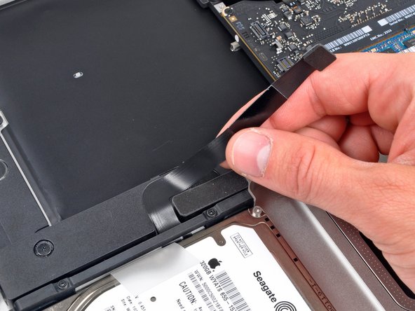

    • Use the flat end of a spudger to pry the hard drive/IR sensor cable connector up off the logic board.
    • Peel the hard drive cable up from the channel within the subwoofer and right speaker.
